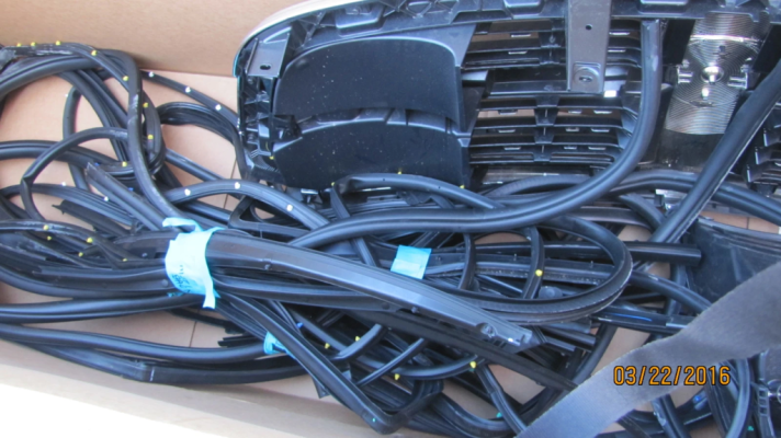

Only the Crew Cab has the Floor Cubbies.
I don't know about the MEGA cabs
On the bottom of the doors, there is a Door Seal
Hidden under the Door Seal, there are small holes, sometimes the seal keeps those holes closed.
DOOR SEALs & others
I don’t hear any water in the doors when I shake then but went ahead and removed the seals to double check and there’s no water in the doors. Idk!
