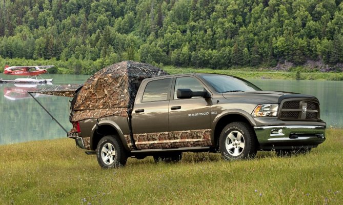

I know, not helpful. but you'll be way over weight with a 1500.43ba862b1268cc6a63fcd0eb68cd782a.jpg
