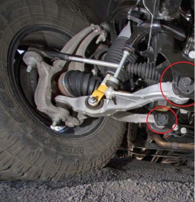

These are the alignment cams:
Basically if any of them are horizontal (the fat part of the cam is horizontal to the bolt) that means its range has been fully used up and the alignment tech probably had to make a compromise somewhere.

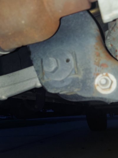

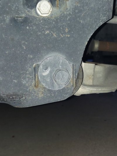

Here are mine. So it appears they are used up. How do I get nee ones?

Wouldn’t the cams affect the steering vice what I’m experiencing?
kurek
Aug 7, 2019
2,661
3,813
Northwest
You don't get new ones, you lower the lift enough that the control arm geometry is within range to achieve correct caster, camber, offset and toe or else you get lift specific control arms that allow correct geometry at your lifted ride height.
My guess is if you had a print out of the alignment for this truck it's probably sitting on too little caster and that's what is giving you that pushing feeling when you steer tightly.
