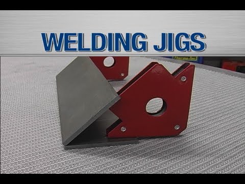

NEVER Practice on the vehicle that you plan to fix up
use scrap about the same thickness
useful magnet
welding pliers

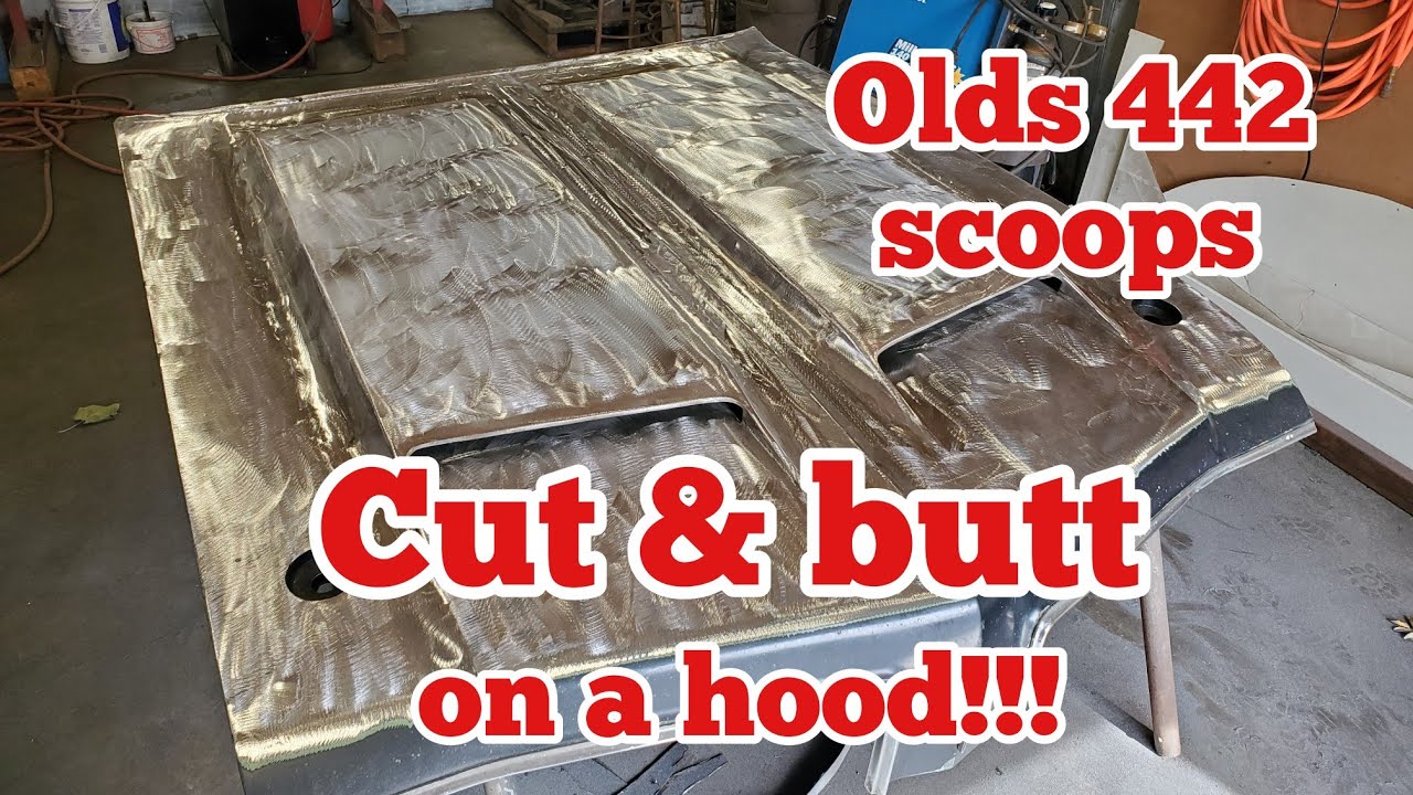

Watching this guy weld. At first I couldn't figure out what he was doing and then I was like "Genius!" The one thing I don't want is a bunch of filler when I'm done and this looks like the way to go.
