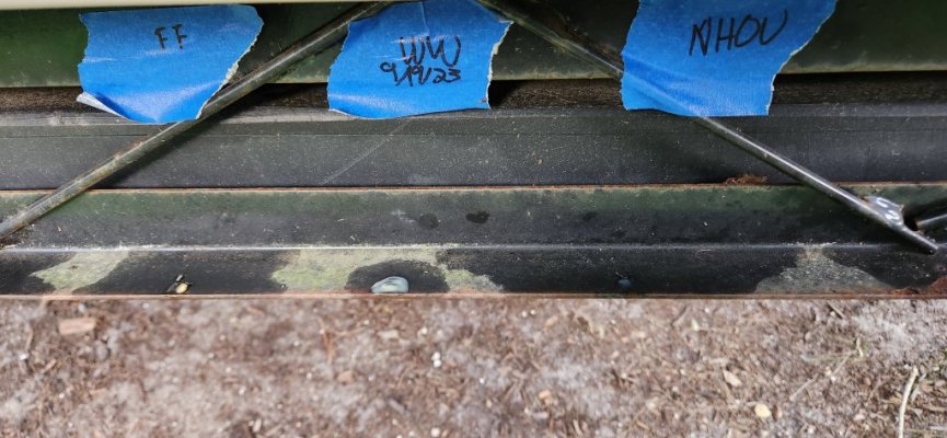

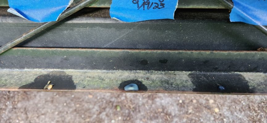

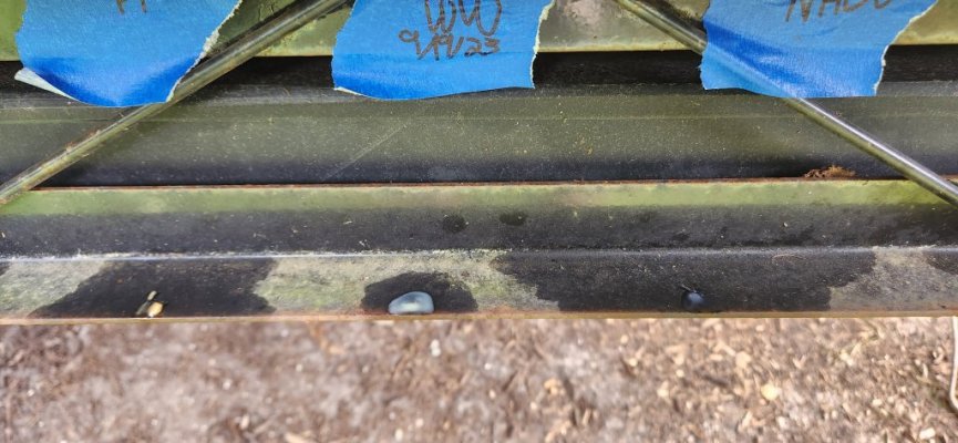

So is there an update on which product you are recommending?
I still going with Woolwax. It takes a long time to creep but it does creep. Heres a pic of a spot I hit real quick last fall on my camper. I literally sprayed real quick just on where the bolts go thru the frame. You can see how far up the frame its crept.
Also it seems to resist wash off better than other products I've used.20250724_181538.jpg
