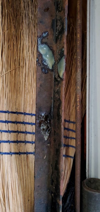

Sprayed my truck with Woolwax this time. I still saw some remnants of the WW I sprayed on it last October and I figured I'd use that again.
My only concern with WW is bscause it's thicker, does it creep into existing rust and cracks/crevices like FF does? So I sprayed a spot of FF and WW onto a rusty piece of metal on Sunday and checked it tonight. Both are creeping about the same which is good news. Top spot is WW and bottom is FF.
Reactions: U&A

it is supposed to. I switched to woolwax about 3 years ago. love it

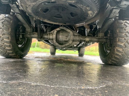

Just spent today doing the annual FF. Used up the last of the 5 gallon bucket i got a few years ago. I had more left than I thought but it worked out as i power washed the crap out of the underbody a few times over the past few weeks to prep.
I used 2 gallons:birgits_tiredcoffee
Most I ever used. She is coated really well. Next is the inside of the doors, rockers and all that jazz.
Next year Ill try WW i think

Looks like you have 0 rust starting under your truck, looks great!
How hard did the residual FF and dirt come off with a power washer?
Reactions: U&A
Pretty hard
I never got it all by any means. But the heavy/thick spots of mud/FF mixture all came off. My old 2100psi power washer would not do it hardly at all unless I used the “0 degree” nozzle. But that is to time consuming and hard on certain stuff. Our new 3200 psi wash took it off with the 15 degree nozzle.
It definitely made it look better under there as it was getting pretty caked on in spots. And it revealed rust free steel underneath.
Im super happy with the performance of FF.
The first 2 years I did a fall and spring application with the spring one being very light. The 3 years after that were just a heavy fall application. I try to do the doors, hood, pillers and higher up places every other year and the inside of the frame, rockers (inner AND outer) cross tubes on the frame, tailgate bed sides, fenders, wheel well liner lip...... yada yada high wash areas every year.
There ar 2 places with very minimal surface rust in spots.
Between the leaf springs .... and i spray them as best i can. I also shoot some penetrating oil between them a few times a year (when I remember)
The other spot is the steering box. It is cast iron though. And its not noticeable unless you look for the rust.
