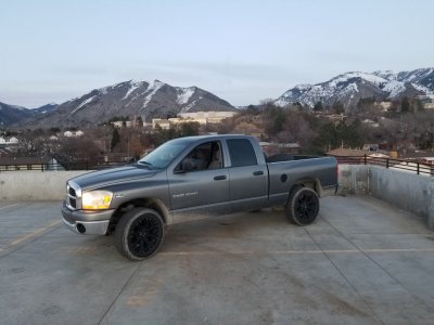

20190331_195455.jpg Screenshot_20190615-113006_Facebook.jpg so the red truck is the parts truck it just hit 160k miles and mine just hit 150 so they are close on miles. My threw a rod and his has a bad trans. Interior is about the same trim level and gears are the same but his has a 4in lift and new brakes. That's why I was wondering about the trans swap

Honestly for the work involved (having done both) the trans would be the easier/quicker swap. If this were me I'd choose the one I like better (which also includes feeling better about, condition, maint history, etc) and do the work to that one. Once you have a running usable truck again, then you can either use/keep the other one for spare parts or if ambitious enough, fix it up and sell it.
