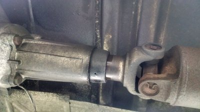

Finally got under the new Ram I bought, 99 1500 5.2 4X4, and found some stuff I was unsure about. The first picture is where the rear driveshaft leaves the transfer case, looks like its been shifting in and out. Possibly shaft movement from bad pinion bearing? I do get the "clunk" going into reverse.
Also the fluid that was gathering in the same area was black so I'm sure I need the transmission serviced, not sure if it's ever been done.

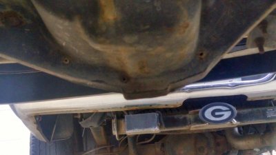

Also have some what look like holes in the back of the front differential, do these look normal?

you will want to remove the driveshaft and check to see if there is a snapring in the shaft after you take off the rear t-case houseing. get a new seal as well (the black thing). you will also want to order the "transfercase saver), google and buy, and put in place of where the snapring is/was.
as far as the holes in the diff i wouldnt worry about it as you wouldnt be losing fluid from there but for sure weird and my bet is had a custom diff guard set up at one point
