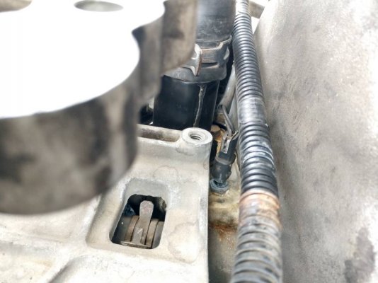

Well well well.... So I had a lot of time on my hands at work. I no longer builds police cars for a living. A few months ago I got hired on at Cord Financial as a Warehouse Coordinator. Over night my office computer decided it was done. So today I pretty much organized things in the warehouse and did some clean up in the office between orders. Basically my boss had to bring the labels to me and process the orders on her end.
So I decided to take a peak under the hood again to try and find this elusive coolant leak. I fixed the some on the water outlet but my heater core kept gurgling and it started to be more frequent... Today I found it...
I replaced it during lunch, now it's just a matter of time to see if it actually fixed it. I did notice on the old cap some extremely small cracks around the edge of the seal so my guess is when the cap is on there it squeezes those cracks open further. Then me constantly having to move it to add water means I kept degrading it further each time I took the cap off.
