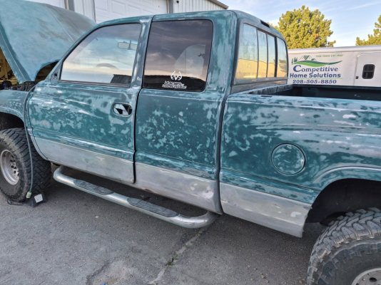

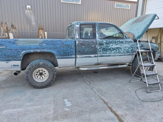

She's getting primer today. This started as a "lets get the peeling clear coat cleaned up" Whoops I got carried away..

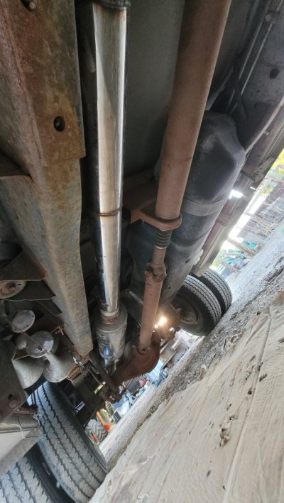

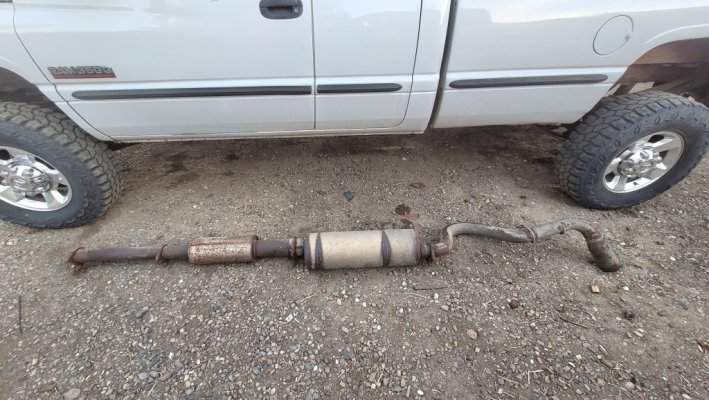

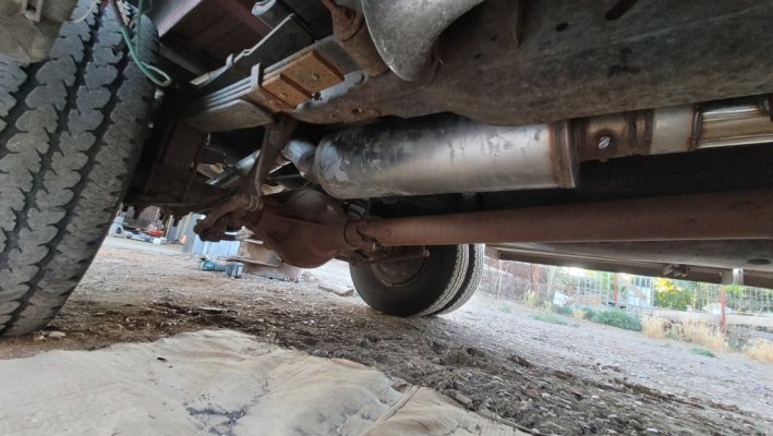

Today i messed with my non working cruise. Got tired of that and decided to do something fun.
I enjoy exhaust work so hacked off the stockish exhaust.
4" off the 3" down pipe. Exhaust i originally had on my f150 5.0 but it was way loud
36" 8" diameter cheap muffler and 4ft cheap stanless pipe sections. Stainless is less expensive than just aluminized.
I gave up on tail pipes poki g out the sides and back. Everything axle dumps now.
Truck is deeper sounding alittle more whistley but still quite enough. I run 5" and two fte twisters on the 02 more turbo and man this 98 is quite.
I may go back to 4" on the 02 kinda out of my loud faze.

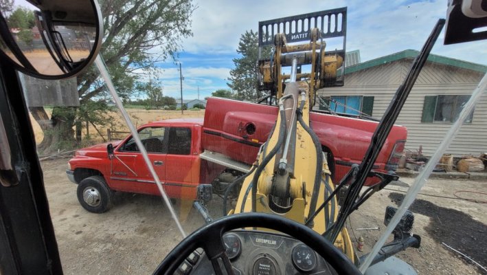

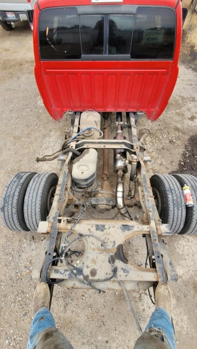

Starting process to pull bed off 04 then drop on to 98 and fab anchor points

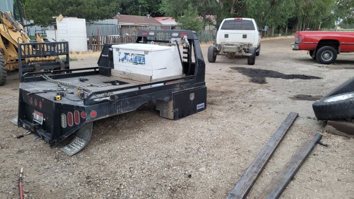

Got bed detached from donor truck
I think its going to look sharp with 3rd gen srw wheels only tires i have right now are 35s.
Debating what streetish tires i want to run. I run mud terrains on my 02 and f150.
The 98 will be burning freeway every day

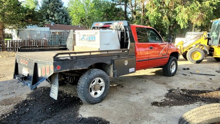

20260620_200616.jpg20260620_200309.jpg20260620_195133.jpg20260620_195709.jpg20260620_195925.jpg

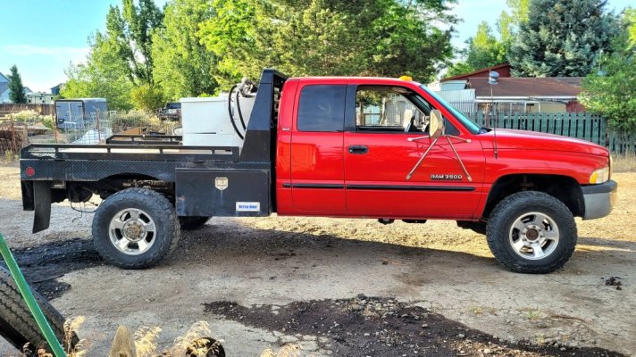

Bed is sitting on the subframe i fabbed. Im off 1/2"ish. Need to kick it sround some. Measuring off door lines its off. Not visual though ughhh im just being picky. Need to just crawl under it and burn it in.
I bolted to existing bed locations have not changed original frame
