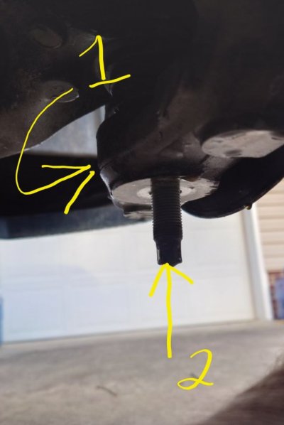

Welp... I attempted to replace the lower ball joint on the passenger side. I replaced the driver's side one a couple of weeks ago, but weather and other commitments have prevented me from doing the passenger side. Today - I had no issues UNTIL I got to where I was trying to separate the steering knuckle from the hub... WHOEVER designed this needs to be put out to pasture. The ball joint is apparently corrosion welded to the aluminum knuckle, and I can't get it out. I've tried several different pry tools, a ball joint separator (which didn't fit - it only goes to 2" wide and I need one that can go at least 2-3/4" wide to fit over it and the knuckle), and pretty much cursed it, yelled at it, smacked it with three different size hammers, used a pickle fork on it, lubed it with penetrating oil, and cursed and yelled at it some more. It refuses to budge. I've given up for the moment. I have a better ball joint separator arriving tomorrow EVENING - but I don't think I'll have time to work the problem before it gets dark... Needless to say, I am beyond frustrated. I do NOT have a blow torch to try heating it and letting it cool while beating it with a hammer. As of right now, my truck is not driveable, even if I put everything back together, the ball joint is completely shot and needs to be replaced. Some pics for entertainment of the little B*STRD.
View attachment 538254View attachment 538256View attachment 538255View attachment 538257
Put a jack under the balljoint with some tension. POINT #2
Then strike a blow with a hammer at POINT #1.
Couple shots should pop it out. If not a little heat around point #1 helps.
THAT DID IT! YES! Took a LOT of blows, but it just let go finally! Thanks!

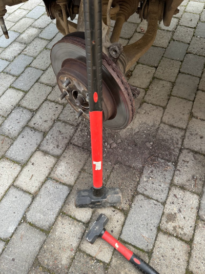

My disc brake was the hardest to get of, I hade to take out the big sh*t

So you were able to get it off?
Next time try hitting it between the lug studs, sounds counter productive but it helps break up the rust holding the rotor on...
Yes, a little tap with the big one and it was loose. With the small one I used all my strength and nothing

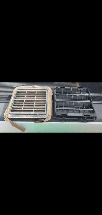

Changed out the cab vents and third brake light gasket because I found water under the back seat. Luckily the vents are cheap and easy to replace.
Sean J Blackburn
Dec 1, 2020
297
431
Arizona
2010
Pics, looks like they changed the design of the cab vents since 2010.
