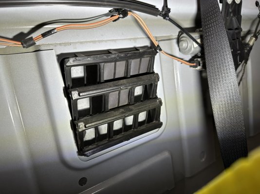

Not mine, but my dad's '14. After I told him about my moisture issues and doing my cab vents/rear seat mod, he checked his truck and had 3" of water in the rear wells. So we did his cab vents, 3rd brake light seal and the rear seat mod. His cab vents only had 1 flap left on the driver's side and 3 on the pass side. He'd also had a small amount of water seeping into his headliner.

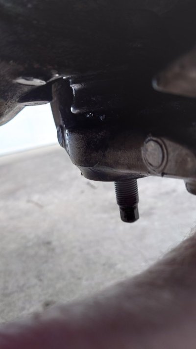

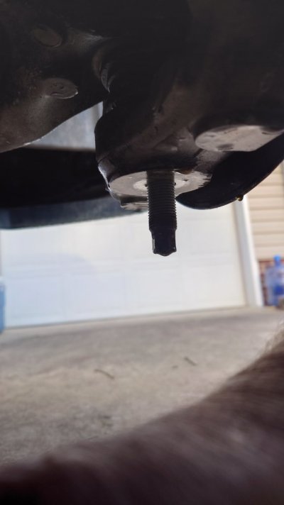

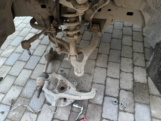

Welp... I attempted to replace the lower ball joint on the passenger side. I replaced the driver's side one a couple of weeks ago, but weather and other commitments have prevented me from doing the passenger side. Today - I had no issues UNTIL I got to where I was trying to separate the steering knuckle from the hub... WHOEVER designed this needs to be put out to pasture. The ball joint is apparently corrosion welded to the aluminum knuckle, and I can't get it out. I've tried several different pry tools, a ball joint separator (which didn't fit - it only goes to 2" wide and I need one that can go at least 2-3/4" wide to fit over it and the knuckle), and pretty much cursed it, yelled at it, smacked it with three different size hammers, used a pickle fork on it, lubed it with penetrating oil, and cursed and yelled at it some more. It refuses to budge. I've given up for the moment. I have a better ball joint separator arriving tomorrow EVENING - but I don't think I'll have time to work the problem before it gets dark... Needless to say, I am beyond frustrated. I do NOT have a blow torch to try heating it and letting it cool while beating it with a hammer. As of right now, my truck is not driveable, even if I put everything back together, the ball joint is completely shot and needs to be replaced. Some pics for entertainment of the little B*STRD.
View attachment 538254View attachment 538256View attachment 538255View attachment 538257
Oh man that sucks!
Mine are getting some play in them and this scares me :eek:
Keep us updated how things go tomorrow night.....
I used this ball press and it worked ok for removal, a bit harder without the right adapters when pressing in the new one.
Starter kit I used: https://otctools.com/products/ball-joint-service-kit
OTC tools says this is the right kit for our trucks: https://otctools.com/products/chryslermitsubishi-truck-ball-joint-adapter-set
I still have right side to do too...
It is much simpler and quicker to just replace the lower control arm that already has the ball joint pre-installed.
Agreed its much easier. Get an alignment and you're good.
However it sounds like @Black-Wolf is having problems getting the old ball joint to separate from the knuckle...
Not the issue. Still would have to get the ball joint to separate from the steering knuckle - and THAT's where I'm stuck at - it won't let go. You still can't replace the LCAs until you get the ball joint out of the knuckle.
I have a ball joint press... the problem is getting the ball joint shaft end out of the steering knuckle. The driveshaft is in the way of trying to use a regular press. The separators I have borrowed or bought are all too small for the size ball joint and knuckle thickness - measured it and it's 2.75" from the top side of where the ball joint shaft goes in the knuckle, to the bottom of the ball joint shaft. The normal ball joint presses only reach a maximum width of 2" or 2.375". The cheap Chinese crap I bought on shamazon might work because despite what the ad says, the center body of it has 3.3" of depth/clearance, and I think I can finagle it into position and use constant pressure and striking to free the joint. If not - I'm going to have to cut it out somehow. Here's the link to the product: Amazon
Let me know if this works, I'm ordering it if it does
