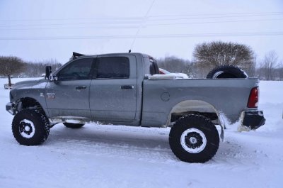

Right now it will just be 265/70R17....same size as my pic over<<< And it it leveled 1'' right now. Need to buy Torsen bar keys and then it will be 2'' leveled. Thanks:)

Here is some pics of his truck:naughty: I have been getting some more mods since the pics. 38" tires and another 3" of lift.
