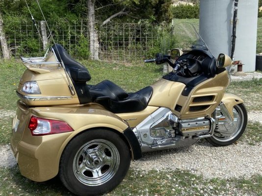

Here in TX, U on the highway say at speed limit 70 MPH, U get run over, which is why I do not ride my BIG A Z Z Honda Trike on IH 35. I normally run 76-80 on the highway and that is still slow for the highway, but THE friggin HEMI as U know once U get over 75 MPH your Gas Guzzler (lol) will adjust the numbers down accordingly.
