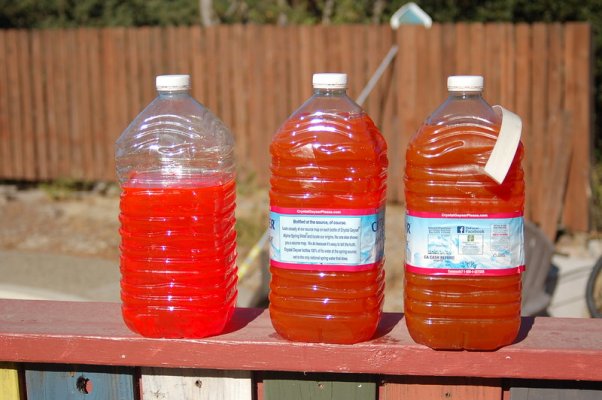

You are over due for a full flush.
It shouldn't be red but orange, have you had the truck the entire time? You can see mine was getting dirty at 7 years, the left is the clean coolant.

If it is really red, that is the euro coolants, wrong coolant for sure. Unless you said red but kinda looked like the one I put up.
