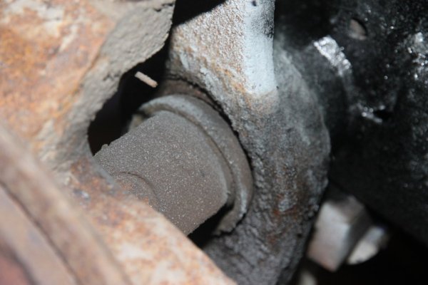

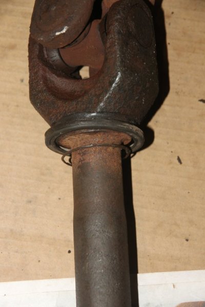

I'm the second owner (started at 83k mi). Shafts are original, good condition
U-joints were replaced in 2022. Ball joints 6 yrs ago. Boots are not present on this MY/model, see pics. There is a "sealing ring", which rotates w/the shaft and does not attach to the upright leaving tiny gap. After a while the ring disintegrates.
Not a best design...
