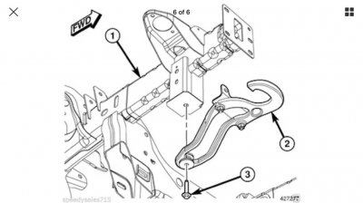

What is this for? A jack point?

is it stock? I have that on my 1500 but I thought it was for a tow hook

^ Yep, snow plow prep group.

Anyone know what this is for? It's bolted on to the bumper supports I think? It is a jack point? Anyone remove these?

I know on my 2500 I could remove them.. I did see them on my 1500.. but haven't looked at them enough to see if I could remove them..
When I had my bumper off - they were staring at me! Looked like a buck tooth truck!

Also, can be used for front mount hitch. My son can easily maneuver trailers into tight spaces with his Ram 2500's front hitch.
I use them for jack points due to having already a winch and adding a front mount hitch up front would make changing the oil filter on the Power Wagon 6.4L somewhat more difficult.

On the 1500 the tow hook bolts to that, there’s a threaded insert in the bottom

its purpose has nothing to do with snow plow or anything like that. Its purpose is to prevent your truck from literally running over smaller vehicles. these drop brackets will hopefully collide with the other vehicle's (smaller cars) bumper frame - not just the plastic parts. This prevents the tires from running up and over the car. they are known as "compatibility brackets". Please don't spread the mis-information about snow plow prep group..

Hmm, just googled it and you are right. They are so we don't monster truck over other cars. Interesting.
2017 Power wagon owner here. Accident in Dec 2017. That is how I know. For the record, they don't work all that well. Everyone was ok for the most part, however, if anyone was in the back seat of that car, they would have been dead. Truck went through the trunk and all the way to the back seat in a Lexus. That is how I know. Not boasting by any means. I am sure that there is a study somewhere where these worked, but in my case, the front bumper pushed the car down far enough that these brackets skipped over the bumper frame and through the vehicle I went.
