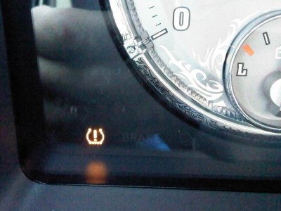

What is this light on my dash?
tobyjohnson11
Nov 7, 2011
63
This light comes on every time i shift into revese. It does not say on more than about 3 seconds. And does not come on anyother time.
Thanks

Thats your tire pressure light. Not sure why its only coming on in reverse. Have you checked your manual?

tire pressure monitor. YOu have a tire that is low. It should also come on your Evic and tell you which tire is low

Just checked that and they all show 42 execpt one and it shows 43.
None of the tires are low.

HAHA Yea I actually just put some in the reverse lights.....:eek::eek::eek: HID's mess with the TPMS?

DING DING DING!!!!. I don't know how they mess with them.

Yep. Haha. It's the HIDs in the reverse light.

^^^^ Correct they are standard on the longhorn trucks.

Mine do it when I turn headlights on. At least most rams do. But I'll see if it still does when I get my denso ballasts.

makes sense, hids often interfere with radio signals, tpms sensors use similar frequencies to communicate with the tpms module
