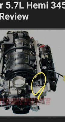

Putting the truck back together after a cam swap and cylinder head refurb and I came across a bracket i forgot to label. Does anyone recognize where it goes? 2012 Ram 1500 with a 5.7LScreenshot_20201206-130207_Messages.jpg

It’s a support bracket. It goes from the front of the driver side cylinder head to the timing cover.

Thank you! I've been crossing my eyes for days looking at pictures and drawings trying to find it. Much appreciated
