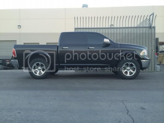

I just saw this picture:
Would the Maxtrac part number 1906 give me this same outcome on my 2wd or is this truck 4x4?
