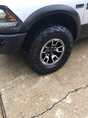

Factory Rebel wheels are 17x8 +18 offset. You should be able to fit 305/70/17 or 315/70/17 tires with a level. I'm running BFG KO2 315/70/17 myself on 17x9 -12 wheels.
51122187473_f21f86204e_k.jpg2021-04-17_07-35-34 by RAM RSM, on Flickr

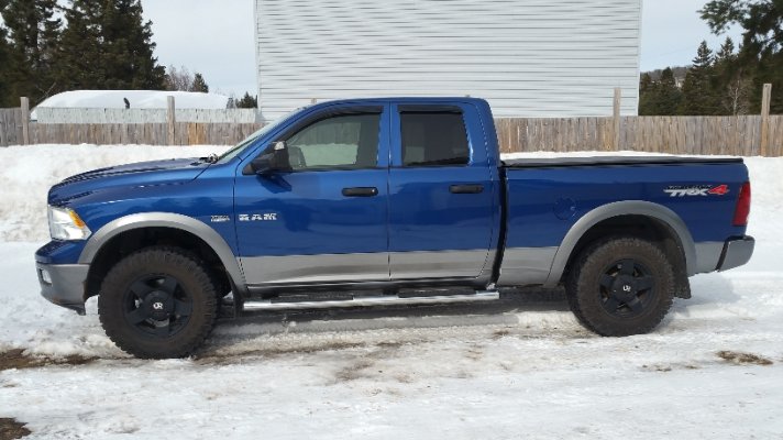

On my 2010(really regret trading in) 3.92 gears.I was 285/70/17 duratracs... they seemed to last forever
On my 2016 I went 285 75 17 toyo ATiii
They are far quieter than the duratracs but I find toyos are not as wide as other brands in the same size. Of.course they fill the wheel well out but this truck being 3.21 gears you can feel a difference from when I had 285 70r17 on it to going up in size
Rim offset is +10
Both trucks leveled
2010 bilsteins 2.8
2016 eibach pro lift 2.75
