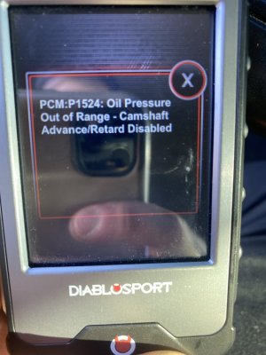

Getting these codes on stock flash. Gotta drive home (700 mi) before I can pull plugs, which were put in 10/19 and have 60k on them. The codes will come on, then as I’m typing literally disappears off the dash

Had there been any luck in replacing the lifter versus the full cam?
man idk most people i see with lifter issued replaced the whole cam. if you caught it early enough you might be ok thats why people are saying dont drive it. I could also be totally wrong on this- does it make a noise when running. also it could be a bad battery

It kinda has the tone of the normal hemi tick. I have a 2nd battery in the back for the audio so I’d say battery idea is out. The plugs looked like trash when they came out so I’m assuming it’s cam. Now to find a shop who isnt gonna charge me 6 grand

oh man that sucks- so sorry !!!

Just crazy reading, some guys replacing manifold studs twice in 50k miles. Passenger side got me a month ago, at 112k miles. but I’m just shocked how these will eat up the cams like this. Half tempted to just total it out lol
