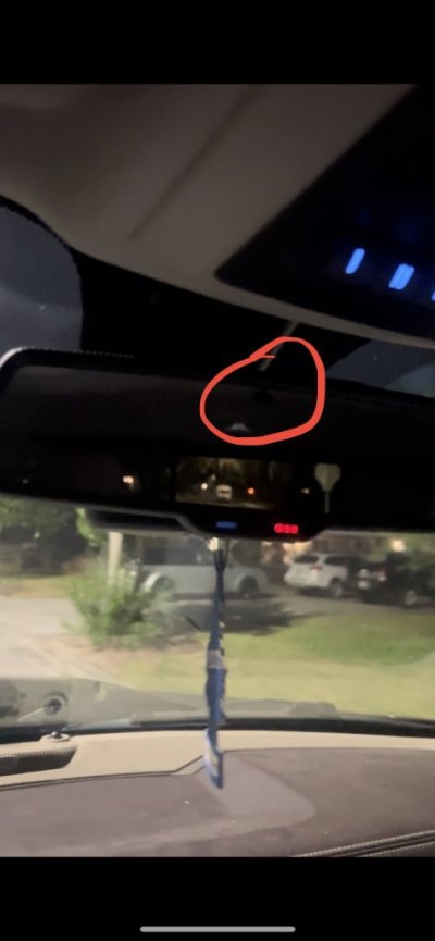

Updated my software the other day and noticed this red light blinking in my rear view mirror that night.
It’s still blinking, I’ve never noticed it before. What the heck is it and what does it mean? Couldn’t figure out how to upload the video so here’s a screenshot. It’s slowly blinking.

No bro. The red light at the top of the mirror. It flashes slowly.
Not the 911 button
A bit tricky to determine from the picture.
Could you get a picture with a flash so we can see all the details?
Maybe, draw an arrow or line towards the errant LED.
Then I can look at mine tomorrow.

Have you recently had your windshield replaced? When I had a windshield replaced in my 2013 Laramie, the installer told me the flashing red light at the top of the mirror indicated the auto-high beam feature required a re-alignment due to the windshield being replaced. Once he recalibrated the windshield electronics, all was good.
If you did not have your windshield replaced, something caused the auto-high beam circuit or other windshield-mounted sensors to think it needs to be aligned. You may need a trip to the dealer to resolve this.
Please let us know the outcome.

My tinfoil hat says it's a "3 letter group" tracking you.
Serious though, my owner's manual says nothing about that red dot. Is it maybe reflecting something in the overhead console or behind you?
For sure a little circle there and then a light coming from behind it. Can see the little circle where there is no mirror there when the light is off too. You can see in the photo even the bulb is behind there and it even shines through some of the mirror to the left of the circle.

I’ve got no air bag warning light. But this might be the case?
I like bosshog’s answer, I didn’t have the windsheild replaced but when I just got obd and checking things out I hit the “realign high beam” function because I didn’t even know I had that option, but I was parked in the garage so it might have thrown them off lol

I didn’t have the windsheild replaced but just got Alfa obd and checking things out I hit the “realign high beam” function because I didn’t even know I had that option, but I was parked in the garage so it might have thrown them off?
I just read this same story on a Charger forum. The user tried an alignment with AlfaOBD and the flashing LED started.
I've also read that this calibration has to be completed at the dealer, at night and they use a grey indexing card while performing the alignment.
That doesn't translate to you must pay a dealer before attempting the alignment yourself.
I doubt that this LED is misbehaving in my mirror because it would have driven me nuts already and I would have covered it up with black electrical tape. :cool:

...I’ve got no air bag warning light. But this might be the case?
But your truck's Airbag light *does* come on before you start your truck...when all the other lights come one (to show you they're working), right? I mean the airbag bulb on the dash does work, right?
It looks like BossHogg called it, the Auto-High beam alignment with AlfaOBD is the likely cause.
You may want to exercise more caution with your AlfaOBD experimentation, you could cause very serious and unwanted side effects.
No matter how safe a function might appear, I would spend time researching before becoming the guinea pig. :cool:
The very first 'best practice' item for using AlfaOBD is to copy the current vehicle configuration, then you will always have a bailout.
Instructions are in the AlfaOBD thread, YouTube, and many other places online.
Although it is less than ideal now, better late than never. I would suggest you copy the current configuration now before making any more changes.
Once you correct this issue, you could make a new backup.
