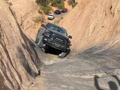

Very Happy with my Thuren setup. 1/2 inch front springs, rear springs, front/rear trackbars, fox 2.0 shocks (king shocks were out of stock and a little spendy for me) king front steering dampner, rear swaybar links. I rarely tow but i usually carry a couple hundred pounds of gear in the back and i will load up with camping gear at times.37 1 - Copy.jpg

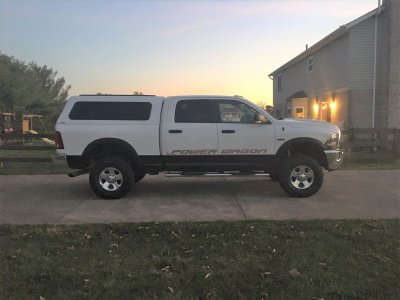

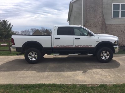

If you like the stock stance than go with the 1/2" springs. I put the 1 1/2" springs on mine and it had a solid 1 1/2" lift on the front, and I wound up putting a 1" spacer on the back because I thought it looked nose high afterwards. The other downside is that this lift makes the 35's look too small!

Yea, if you want to retain a little bit of rake without adding a rear spacer, get the .5” springs instead of the 1.5” ones.
And yes, if you want to just stick with 35’s, the 1.5” springs make them look a little on the small side for sure.

Here is my '16 with 1.5" front coils and 1" rear spacer on stock springs with 35's. Obviously has the weight of the bed cap, which is a little more than typical because it has the side cabinets inside the side windows.
