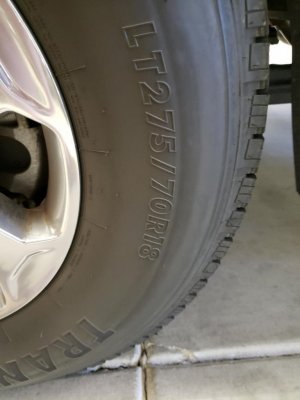

My 2500 came with 275/70R18.
These are 285/75-R18.
10mm wider and slightly taller (34.8").
FYI: This causes my speedo to read 3 mph too low at highway speeds.
I like that they are still somewhat suited for off road and still a good deal quieter than the M/T tires I've run for the last 30 yrs.
They are an E rated tire. Check the specs on them for the exact numbers but they are each rated for 4,079 lbs..a8ce38ca7cc2244c1f0c42478f44dccf.jpg164288390bc3d5f353fdf23ea7c0a468.jpg
They are an E rated tire. Check the specs on them for the exact numbers but they are each rated for 4,079 lbs..View attachment 460105View attachment 460106
Are you running stock suspension/wheels? If so, do you have any tire rub or scrub at full lock??

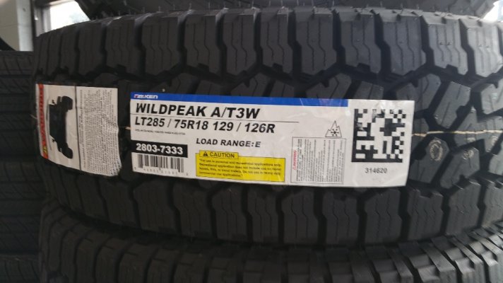

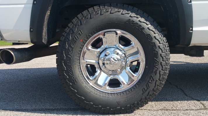

Run Falkens AT3W's "C" Rated for multiuse. Stock 18" size.
