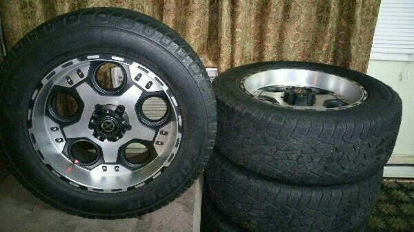

So when I first bought my truck I had these rims laying around from my 06 Ram and put them on my current ram for a month or 2.
My ram was stock suspension yet these wheels fit with no issues at all. Here's the specs:
•• Wheels ••
[emoji830]Brand: American Racing ATX Justice
[emoji830]Size: 20x9
[emoji830]Offset: -24
•• Tires ••
[emoji830]Brand: Cooper Zeon LTZ Xtra Large Series
[emoji830]Size: 275x60R20
[emoji830]Diameter: 33"x11.1"
So if my 2012 Reg Cab fit 33x11 tires, can a 2011 Reg Cab with the MaxTrac 2.5" Level kit fit 35x11 or 35x12.50 tires on it? These fit on my truck with no rubbing or any issues at all and it was stock height.
Also these were -18 offset. He wants his to stick out more so can he run upto a -28 offset with that MaxTrac kit and they still fit on his truck? Again his is a 2011 Reg Cab same as mine.
Here's some pics of what they looked like.
