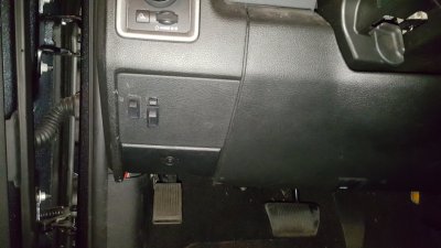

whats this part?
maple
Sep 18, 2015
281
103
San Bernardino CA
So i was adding some aux switches to my truck tonight and thought i found the perfect spot to put them... i was wrong and messed upthe little panel under the light ***. Anyone know this part number so i can order a new one?

Eye balled the **** out of it lol plus there's a lever or pull Handle behind that panel for something. Its in the way of the switches so they stick out :superhack:
That's exactly what happened to me. I used a rubber grommet to give the switch more backspace. I've looked for a part number, but have had no success.
The piece you see behind it is the manual release (neutral switch) for the electronic 8-Speed transmission. You pull it out prior to being towed. If you try to leave the truck in neutral (or drive or reverse) from the shifter, the truck automatically puts it in park when you try to turn the truck off.
All of the guys saying its the perfect place to mount a switch don't have the 8-Speed...

Take the picture to you dealer parts person, he will identify it for you.
That pull handle releases your Tranny if you loss power.
