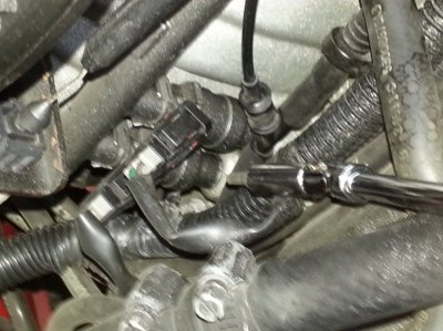

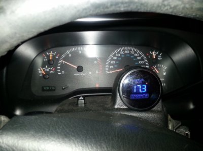

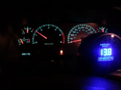

I first started noticing my truck having a high idle problems. Idle in park (1600-1800 rpms) and idle in drive with the braked pressed (around 1400 rpms). Air/fuel was around (13-14). It also had a bogging moment when letting off of the gas and slowing to a stop light. (air/fuel jumps to around 20-21). The truck is not throwing a check engine light code.
1. I cleaned the idle air control valve (wasn't really dirty and looked newer) and it didn't fix the problem and made my truck run leaner than before. The whole throttle body didn't look dirty at all.
2. I checked for vacuum leaks. I found a few small leaks with a couple hoses. I added clamps to them. I found a large vacuum leak on cylinder #8 fuel injector. I replaced the passenger side fuel injector o-rings. The o-rings I replaced were already new and were not defective after inspection. This did help some of the vacuum leak but it still leaks some even with using a small amount of grease to seal the o rings.
Starting the truck, no matter if it is hot or cold, it will idle at 1100 rpms @ (17-18 air/fuel) and after about 20 seconds it will increase its idle to 1400-1600 rmps @ (13-14 air/fuel). The current tune is adaptive.
After a few minutes at running at idle the headers glow bright red from the engine running way to lean.
My next step is to pressure test the fuel system. I might try replacing the o2 sensor, and fuel filter.
Any suggestions?
