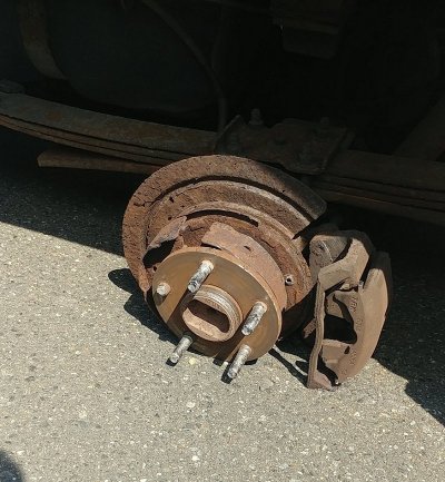

2003 RAM 1500, 200K miles:
Was driving on the interstate when I heard a bump and some noise and pulled over to discover this.
Truck bed had nothing in it, and I was towing an empty Uhaul trailer.
The wheel is nowhere to be found.

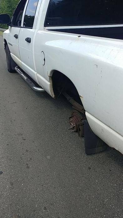

The last pic shows what the other rear wheel looks like.
The axle does not appear to be broken?

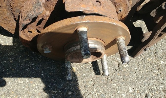

You're lug nut studs look all messed up. They look like they have been cross threaded. One is completely broke. Glad you're ok and whoever was around you.

Not surprised that it's a "beater".. the amount of neglect and rust on that truck is extremely scary. You couldn't pay me to drive that truck. lol

Looking at the picture I would say FullForceRam is dead on. I wouldn't take anything I owned to the "part time auto repair person" after seeing the photos.

That rust isn't that unusual on a 2003 vehicle in Maryland, we like to use salt on our roads in the winter here on the east coast.

If all lor 4 of 5 lug nuts were loosened by someone, it would wobble. And if they were loosened more than one stud would be broken. It looks like threads in 4 of the 5 studs are stripped, which would have been before driving.
The 5th stud is broken near where the lug nut would have been up against the hole of the rim. It appears, without the benefit of the rim to verify, that the 4 studs were already stripped but the lug nuts were probably "stuck" on and the 5th was the one that held the whole thing together. When the 5th finally had enough and/or enough of the others gave up, the result was catastrophic failure. Whoever put those tires on knew there was a problem. Yes, I have seen this before. Tire from a Honda going 40 miles an hour just missed my head. Car lost it soon after having tires replaced. Looked just like this, turned out 3 of 4 studs were stripped.
