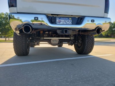

Core4x4 arms and panhard bar with hellwig rear swaybar was one of my best upgrades to my truck. No bouncing left to right after bumps, no wheelhop either, feels much more stable.
Do you have a link for the panhard / hellwig swaybar set-up?

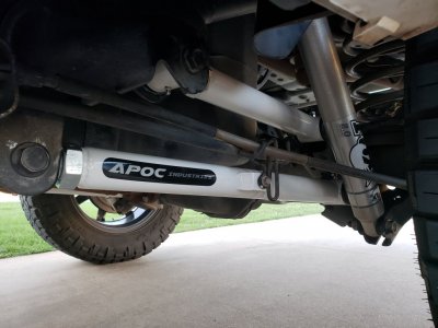

pan hard bar is by Core 4x4, rear control arms are from Apoc Industries.
Awesome ! Ok so just go ahead and replace both upper and lower and looks like I will stick to the Fox shocks since I have them in the front. Would you happen to know the part number for the fox shocks for the rear

they do in house powder coating, they sent me a link, I chose PW7 white to match truck.
Was that additional? Just wondering if color brings it more on par to Core links or if it’s no charge to color... thanks.
yes it was an add on.
