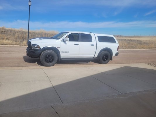

I just switched from 20s to 17s on my 1500 classic warlock. Made a big difference in ride.
Great tire prices and will match deals

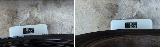

I just went from 17's to 20's (and from 33 to 34" tires, both E-rated and all-terrain but different brands) - gained 15.6 pounds per corner of rotating, unsprung weight. Not all of that is the wheel diameter but some of it is.
