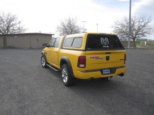

Looking for some insight on wheel spacers
I was looking at some wider fender flairs and wanted to push the tires out flush with them
Being I have new wheels I don't want to replace with appropriate offset
Once I have the new flairs on I will know exactly what I need, but looks like it will be 1.25" to 1.5"
What are the pros and cons and who makes a good quality spacer ?
here is one I was looking at , Any good ?
Supreme Suspension Wheel Spacers for 12-16 Ram 1500

big con on the 1.25 is that you definitely will have to cut your studs. 1.5" spacer might only have to grind them down a little

Would I be better off going with a 1.75" or 2"

That brand is fine, running them myself. Several threads discussing these.
I did 1.5" and running stock 20" chrome clad wheels. If I was doing it over I would've done 1.75" or 2".
I didn't have to trim anything but the studs do extend past the spacer slightly. There's a recess in the factory wheels so it isn't an issue.

2" would really stick out far since you already have wheels that do stick out. Definitely get spacers that are hubcentric then get hubcentric rings for your wheels if you don't already have them.
