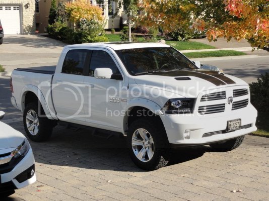

Lots of guys, including myself run spacers without problems. Get a quality hub/wheel centric set, and you should be fine. I have 1.5" BORA spacers to run my stock rims for my winter set up.

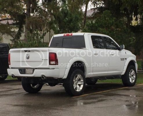

Same as the others have said. If you get a quality spacer you'll have no issues.
I've got the Bora 1.5" hubcentric spacers for my winter setup with the stock 20's.
That's a nice looking truck
