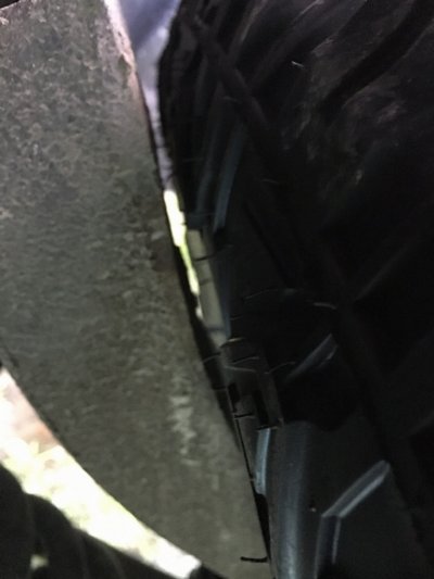

Lastly, why does a 6" lift require a wheel spacers or custom wheels with back spacing? What does the lift do that doesn't allow the stock wheels?
It's a clearance thing. This is the knuckle to tire clearance with a .25" spacer(35x12.5 tires). Without the .25", the tires rub.

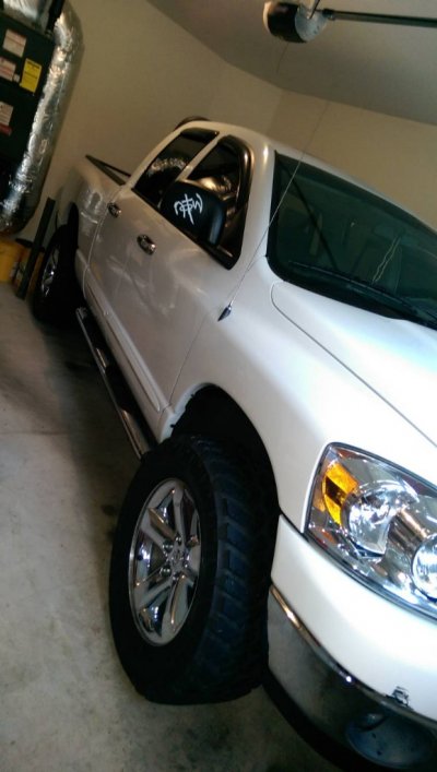

Don't have a great pic as my truck hasn't been like this in about 4 years so I had to dig for this lol but this is 2.5" spacers on stock rims and 35x12.50. Zero clue what brand they are however, my acquaintance who owns the shop ordered them for me565e9d5b58a50d36a2bd90fc0458dc4b.jpg

Thanks for the visual. Is this the knuckle?

Yes, that is the knuckle.
It is longer than the stock knuckle.
