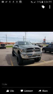

That looks like fuel maverick -24s. For example mine are only 20x10's and -24 look at my dish depth and compare, if yours are x12 - an extra inch on the outside plus another 20mm offset in the direction of a wider stance, yours should be revealing a much much deeper dish than mine.

It's because of the pocket flares..let me find a pic of them without flares..they stuck way put past. Yes they are -44's

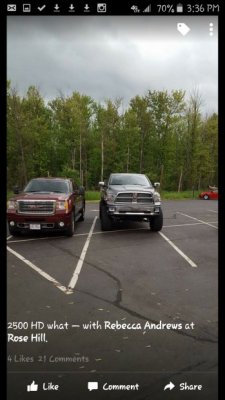

Saw your pics in another thread. Are you just on a 6" or do you have a body lift too?

I'm not even looking/ considering your truck I'm simply looking at the rim itself not even the tire. The larger the offset the more the mounting face changes from the center of the rim. Now specifically on yours it would be -44mm, roughly 1.75inches now that's from center so that plus half your rim 6inches, means your mounting face is about 7.75 inches inset from the front lip of your rim, so back out some for the thickness of your 'spokes' so to speak call them 1.25inch means your rim should be revealing about 6.5inches of 'dish' yours visually looks like about 4 which is closer to the -24. At any rate if this raises a flag to you and you actually paid for the -44 and got the -24's, you could probably get the -44 for the mixup if that's the case which also would give you that extra stance your after. To confirm the size you really have just pull up your wheels manf spec and then go measure to see what offset it matches.

Here's a couple I screenshot before fender flares
No it's got a 3" body lift on it as well. I also just installed a tgc 1.5 rear spacer and going to install the bill 5100s for more lift when i get back home. The pic sitting next to the 2500 is after lift and body lift.

Still looks like -24 to me especially given that's what I have with flares as well albeit smaller flares but still. Not trying to be argumenative, just sayin is all. Easy way to check for sure is to measure your backset and rim width vs manf specs, hey ive been wrong before so take it with a grain of salt
