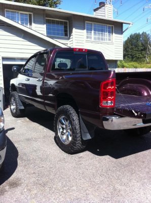

Hey guys. I just got new wheels and when I ordered them, it said 18mm offset. WELL, when I put them on, they dont stick out anymore than the stock 20's. Any ideas on which spacers to get? How much? Thanks

No, they dont rub just want them to stick out a little bit more.

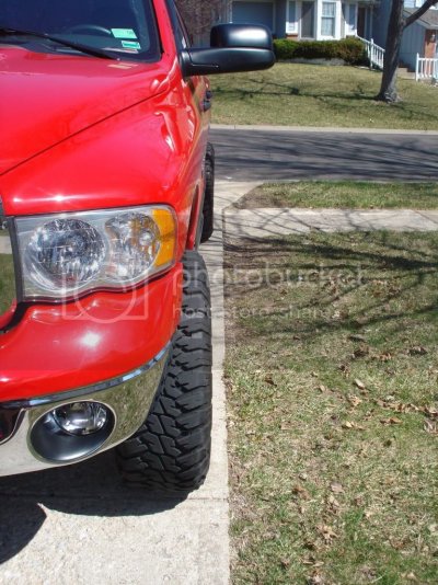

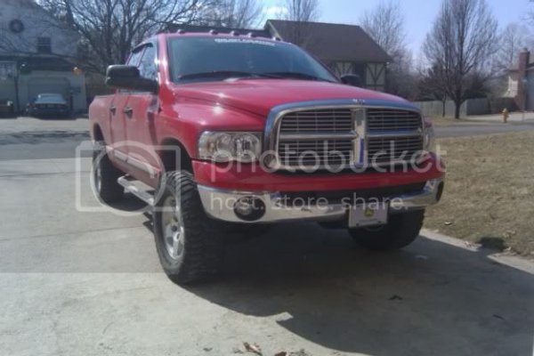

Here are two pics of my truck with the stock 20x9 +18mm (I'm pretty sure thats the stock wheel offset). I have 1" spacers so that puts them at about 20x9 -8mm offset.
Oh and I have 35x12.5x20 Toyo M/Ts

You shouldn't have any problems. My girlfriends truck rubbed the control arms with 35x12.5 stock. I put a level and 1.75" wheel spacers. They'll be taken off as soon as wheels are in the budget
