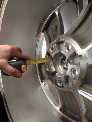

Does anyone know the narrowest spacer that can be run on a 4th gen (2015) ram 1500 without having to cut the wheel studs? Stock sport rims 20x9. They look like they have pockets on the rear side that would accommodate some of the stud that would extend past the spacer. I'm looking for 1" or at most 1.25" spacers.

I think 1.5" to clear the studs

jwheeler may be right , but seems like I've heard someone run 1.25" without an issue .
Measure the length of you oem studs on your hub and subtract the depth of the cutouts in your wheel this will give you the narrowest spacer you can run .
Example : stud = 1.75"
Cutout = .75"
Min spacer = 1.0"
PER the example I'd run 1.25" to be safe .
Remember this is just an EXAMPLE ! You still need to measure your OEM studs and wheel cutouts if your wheels have cutouts .
Hope this helps !

So maybe 1.25" spacer would work. The 1/4" past the spacer would easily fit into the pockets on the back of my stock wheels. Anyone else try this?

If you find you do require shorter studs and you don't want to install shorter ones , you can do this : run an opened ended lug nut onto the stud , back the nut off to the length you need to cut , using the nut as a perpendicular guide to cut the stud straight with a 90° whizz wheel / die grinder , now run the nut down to the hub by hand ,now apply anti-sieize or grease to the threads of the cut stud and remove the nut to clean up the cut area of threads . This method works great !
Replacing the OEM studs is another option , only takes about ten mins per wheel once the wheel is off , with a 4lb mini sledge hammer and an impact . This is an added cost , the cutoff method works well and if you cut off .5" or less there's still plenty to reinstall just wheels in the future .
