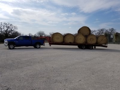

I haul hay several times a year. I have airbags and fill them to 50psi when I haul the gooseneck. Trailer brakes are a must. Picture shows 12 round bales on the load. Typically haul 14 at a time.
