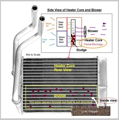

I've read many posts here at Ram Forum and elsewhere where the heater core has been replaced to restore the heat on both sides, and a short time later, the owners continue to experience problems with a lack of heat on the driver's side.
From what I gather, the sediment that clogged the first heater core is likely still inside the coolant system and will likely collect in the new heater core.

I found this picture online that suggests why a partially blocked heater core could impact only the driver's side heat.
