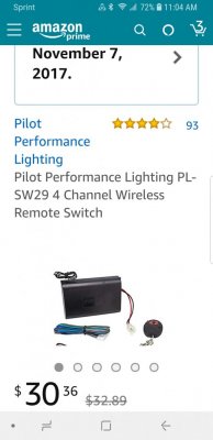

Not replaced but I purchased a 4 chanel remote relay and syncd the homelink to it. 1 homelink for our gate, 2nd homelink for tow hook led pods and 3rd homelink for pods behind grill

Wont let me link from amazon. Type in pilot performance pl-sw29. I had Each of the 4 switch legs from pilot controller energizing a relay controlling seperate lights.
