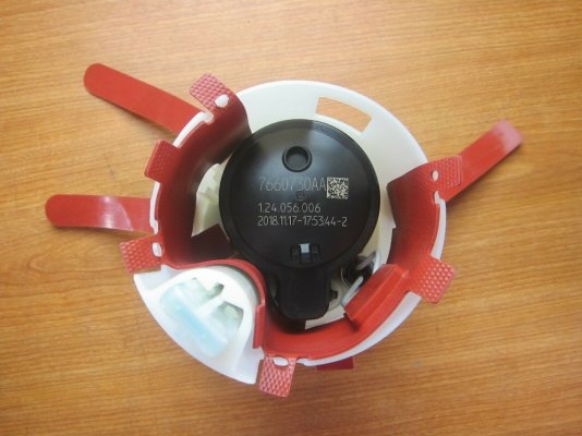

Contaminated DEF is an erroneous error message from the DEF emissions system. There is no special sensor to measure contaminents in the DEF.
This is erroneous. There is most certainly a DEF quality sensor as part of the DEF pump module in the tank. There are 4 components in the DEF pump module; pump to make the pressure, level sensor, heater and quality sensor. I think it was the 2015 that needed an update to the ECM due to throwing incorrect DEF quality messages. The DEF quality sensor is the red finger-like things in the photo below. They float in the DEF and an electrical signal passes through the DEF in the tank. Contaminates and other DEF quality issues change the signal is then interpreted by the computer and a message is raised if outside of certain parameters.
The ********* thing in the middle is the heater, the bluish / greenish white thing in the lower left is the level sensor and the pump is on the bottom (not shown).
