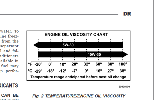

I’ve been looking through the manual and it lists 5w30 or 10w30 but looking through various motor factors in the UK 10w30 seems to be more motorbike orientated.
Searched the forum and went through various threads and 5w30 fully synthetic seems to be mentioned a lot. Is that the best?

Straight out of the 2003 factory service manual:
Screenshot 2021-11-23 at 22-00-54 daimler-chrysler - 2003 Dodge Ram Factory Service Manual pdf.png
