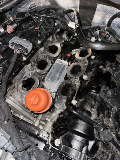

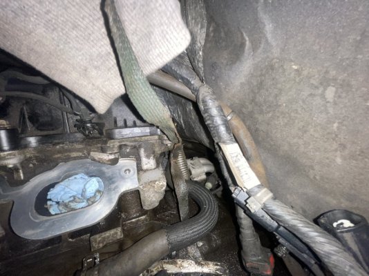

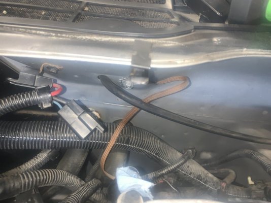

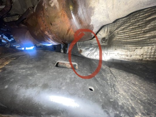

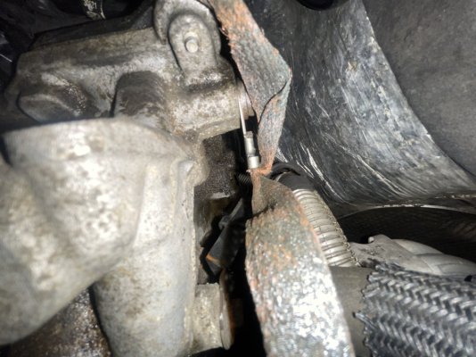

This is what I’m seeing currently (don’t hate me guys lol. Ive just been topping up the oil between the last 2 oil changes because I haven’t had time to park the truck and work on it)
….do you think it’s the filter housing/oil cooler? Or any other seals and gaskets you recommend replacing?
View attachment 574014View attachment 574015
I think you might have a bigger problem. Oil filter housing usually goes unnoticed and appears somewhat like a transmission leak under the vehicle as it blows out of the valley off the back of the engine and leaks down.
I think you are in for a much bigger job...
yeah, that looks pretty bad, like Daw14 said, clean it off first and then see
oil leaks can be hard to track down, i had a 71 duster (still have it, actually) and when i rebuild the engine i put in a new oil filter adapter and wouldnt you know it, it was leaking
so i took it off, put a new O ring on it. kept leaking
then i pulled it off and replaced it with a different 90 degree adapter and THAT leaked
now, heres the kicker, it has to be the oil filter adapter, because the highest part of the engine where i found oil on was the filter which sits on the adapter
after all, oil doesnt leak up, now does it?
i was about to torch it down, it was so frustrating
finally, i taped a napkin around the oil filter and the adapter and took her out for a drive
when i pulled it back in, i found oil...but on the outside of the napkin, if the adapter was leaking the oil should be on the INside of the napkin
i did some more investigating and finally found i had a leaking rear main seal, that oil seeped down onto the torque converter which flung it up onto the oil filter adapter
the moral of the story is, i replaced that thing half a dozen times and never fixed the problem because i wasnt replacing the part that was faulty
now, if you "want" to replace that housing, go for it, but first figure out what the issue really is
