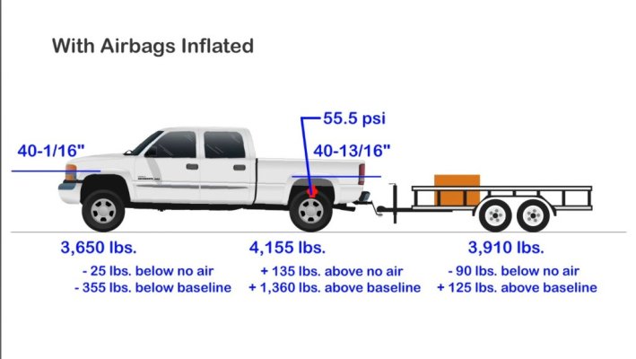

If one is towing a tag-along trailer, using just airbags to level the truck/trailer is a false security, it actually makes the front end of the truck lighter. I've posted a video on this very thing and have had people swear it's nothing more than a sales pitch.
As for a fiver or gooseneck trailer, your correct that one can dial in how the truck handles the load with airbags. We'll leave it at that or the payload police will get their panties in a bunch
I agree that airbags do not replace a WDH in regards to distributing weight on a bumper pull trailer. If I was forced to only have one or the other, I would pick the WDH first. What I am saying is that bags can improve towing performance. Having the rear of the truck squatted way down under a load can cause weird handling. Also soft springs can cause a lot of bouncing. The bag position on a 2500 also decreases side to side sway (personal experience towing with and without bags). This is comparing a truck with no air bags versus one with bags........not comparing bags to WDH.
To be honest I'm not sure how having airbags in a truck to keep it level somehow causes the front end to become significantly lighter as compared to if it was squatted a lot in the rear (again, with no WDH) I know it doesn't transfer weight to the front axle like a WDH. However I don't understand how you can take a truck, hook up a trailer so the rear end squats, than add airbags to level it and the front gets way lighter? I'm not an expert in the field but do have an engineering degree and understand physics. If you look at a side profile of the vehicle and the center of mass, the vertical line showing the weight transfer is typically slightly more towards the rear on a squatted truck....meaning the front would be lighter on a squatted truck and heavier on a level truck. But only by a small amount.

By themselves airbags won't really add/remove weight from the front axle but what they "can" do is give people a false sense of security whereas they begin overloading even more because it looks level. That scenario does remove more weight from the front end, and without a CAT scale you wouldn't necessarily realize it.
Now, if you couple a WDH WITH airbags but fail to reset the WDH to compensate, then it's possible to decrease front axle weight because once you adjust the airbags, you've removed some of the torsion that the WDH applies to shift the weight.
It only applies to when towing a tag-along trailer, but it's physics at work.
Here a video that shows the difference of what happens when leveling a truck with air bags versus a WDH:
This does not apply when towing with a fiver or gooseneck unless the hitch is behind the rear axle center line.

Yep. It's all about placement of the lever. A bumper pull puts a lever force behind the bumper, which raises the front of the truck. The torsion from a WDH pulls up on the tongue and sends some of that weight back to the front axle. With a fiver/GN, the downward force of the trailer is over the axle, so the suspension takes most of that force and the weight taken off the front end is much less.

I understand, but that is not the point I'm trying to get across. In your example the reason the front is lighter is because you have a trailer with 1,000 lbs. of tongue weight on it. The front being lighter has nothing to do with whether it has airbags or not. Remove the airbags and the front axle is still 500 lbs. lighter. I never said airbags somehow stop weight transfer or anything.
Again, my point is that airbags do not magically make the front end "lighter"... Airbags mainly just keep the rear suspension from squatting as much and make it feel firmer (less squishy) when towing.

I completely understand the difference, and again that is not the point I'm trying to get across. My response was based on somebody saying that if the rear of the truck was squatted because of a load, and you put airbags in to raise the rear suspension back up, it somehow made the front axle lighter.
The way I reading this is you didn't bother to watch the video. Dropping 1000 lbs tongue on the rear of the truck not only squats the truck but lightens the front axle. Using airbags to level the truck further lightens the front axle. The video spells this out in black and white(picture from the video): Screenshot_20251021-142444~2.jpg

I did watch the video. Sorry, I don't consider 25 lbs. significantly different, especially considering you are looking at 3,650 lbs. . You are talking 0.68% difference. The scales they use are only accurate to +/-1% of the measured weight, or +/-36.5 lbs. (range of 73 lbs.). Not only is the weight they report insignificant, it's also unreliable because it's less than the accuracy of the scales and there is only one data point. It's completely reasonable if you reset the whole system and did the test over that the front would now weigh 25 lbs. more.
I'm just not making this stuff up......I'm an engineer and do testing all the time. If I recommend making a change at work based on this test setup (insignificant difference, that difference is less than the accuracy of the test equipment, and only one data point) my boss would laugh me out of the room........
