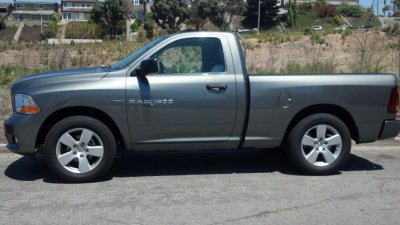

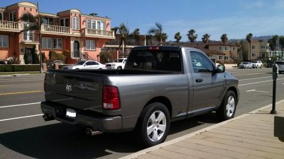

GF 2" rear drop springs would do the trick.
This is how mine sat with them.
thats exactly what im looking for, did you keep the stock shocks?
DavidRam
Feb 19, 2014
9,094
3,921
SoCal - Redondo Beach
2012 RCSB
Yep, they should be somewhere in my garage. As you may know, I have moved on to a 2/4 drop since then...
