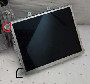

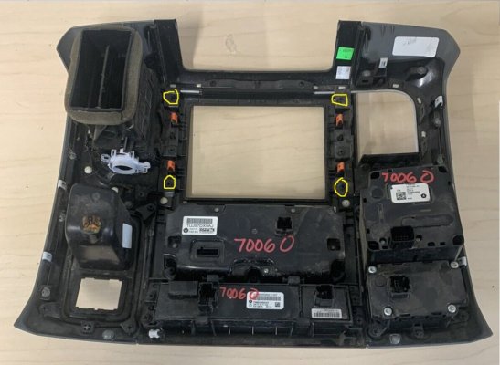

I wish I had pictures of my actual install, but I'll explain what I did. I used 1/8" ABS Plastic and epoxy to extend the top left and right tabs of the screen(circled red in the attached picture), I then cut a slot into the bottom tabs(circled in black). I then was able to use the factory screws(circled in yellow) to attach the screen to the back of the Dash. The radio module is Zip Tied in the back of the dash. You'll also need the HVAC control splitter cable, and alfaobd to enable the separate screen(you may also need a longer lvds cable 68082364AC).
