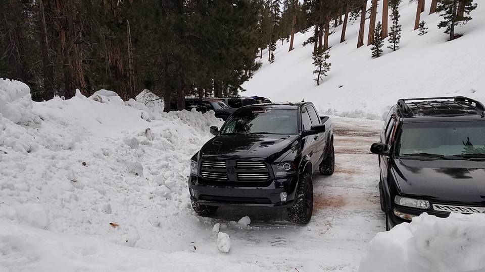

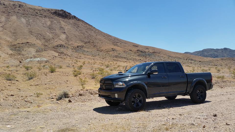

I have a 2016 Ram 1500 Sport with a BDS 4 inch lift on Toyo Open Country 35x12.50 20's which I am trying to replace the shocks and struts on. I put Rancho's on the back and bought Rancho struts for the front but I did not know when I bought the front struts that the lift kit the dealership installed used 4 inch spacers in the front and retained the stock struts. I was planning on keeping my stock springs to put on the new struts but once I take the spacers out the springs won't be long enough and I can't seem to find springs for a 4 inch lift... Can anyone recommend a good set? The truck is mostly on pavement but I do a little bit of light crawling on goat paths through the Nevada desert and I pull a 4 horse trailer with it...
