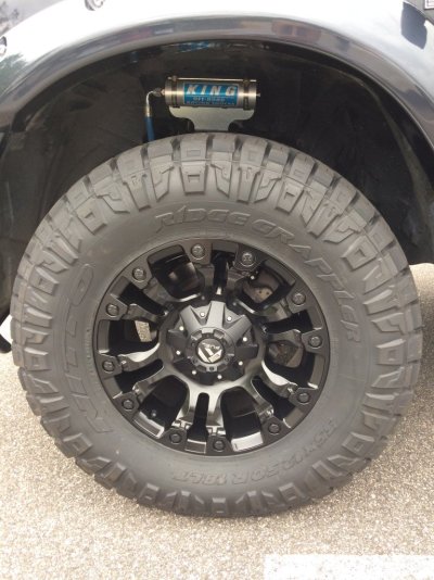

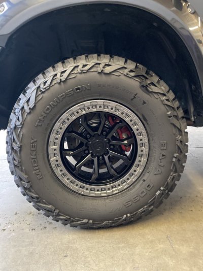

Thanks for your reply. I am running on none stock rims . Not sure of off set but they are off set .They are XD RX2 series rims. They could be 12mm offset
I have 35x12.5” with a -12mm offset, no rubbing issues, my old set had a + 1 offset & had to run 1” spacers due to contact with the uca’s.
Got rid of spacers when I got the wheels/tires.
