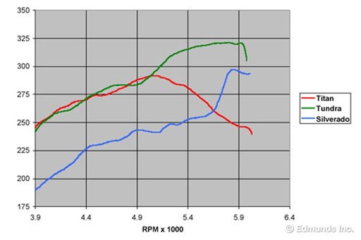

You guys may like this as I found it while looking on the web here
2009 Dodge Ram 1500: Dyno-Tested
It shows the power curve for Ram, Tundra, Titan, & Silverado
It makes it clear why the right gear must be paired with the motor to get max better power to the ground. Unlike diesel the Hemi and all these gas engines need more RPM to make max power so to tow obviously higher RPM will make it easier and seemingly more efficient when doing work. Make sure you look at the numbers on the side of the charts as they are not exactly the same size chart.
The Hemi peaks sooner than the rest making it hold true to the tradition of being awesome :)
