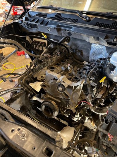

It's obviously been done many times, but not by me. I honestly waffled on buying a new truck , vs repairing this one. Prices of new trucks like my 2012 sport push the mid $80's here in Canada, with leather etc. I've had this truck for 3 years and 150,000 km, long enough to know it well, and trust it. It was 3M wrapped from new, and also undercoated, so it has almost no rust. I figured why not try something that keeps me happy for another 250,000 km?

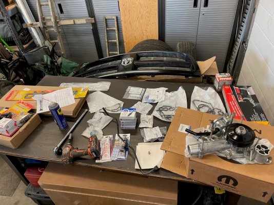

Finding a good deal on a brand new Mopar long block 6.4l sealed the deal, and I started assembling parts for the swap. I did a lot of research on what I thought might be needed, and had most things ready for when my truck came out of the body shop (I had some hail fixed from a big storm here this summer).
This was probably about half the parts I ended up using, give or take.
TBC...

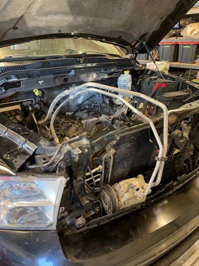

I probably don't need to go into a ton of detail on the old engine removal, that's what Youtube is for. That being said, there are guys out there disassembling the whole front of the truck...
After finding every video and article I could on it, I decided to leave the rad support in, and the hood on. I definitely would do it the same way again, hopefully I don't need to.
I removed the rad, and left the AC condenser in the stock location. Once unbolted, the compressor swings easily out of the way, and sits nicely in a spot with the grill removed. There does not seem to be much stress on the lines at all doing this.

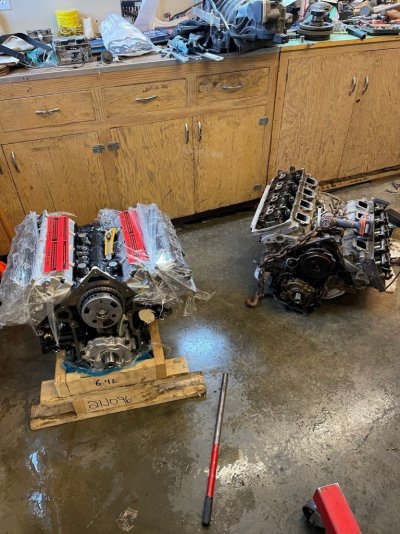

Like I said, I won't bore you guys with the details of the swap, just the lessons learned. The stock 5.7 took me about 12 hours to have it out and on the stand. I pulled the stock oil pan and valve covers, and since my wife was home I couldn't stick them in the dishwasher. I gave them a good cleaning and swapped them over with new gaskets.
The 6.4l needs its own oil pan gasket, as the windage tray is built in. Other than that it was the 5.7l parts put on, including the flex plate, over to the new engine. I used the original knock sensors, and the 5.7l oil pressure sender to match the plug. The 5.7l timing cover bolts right on, and none of the truck 6.4l EGR stuff is needed. A new timing cover crank seal was done on the stand, using a 3/4'" socket, the old seal, and the balancer install tool. The factory balancer was in good shape, so it was reused, although I did not install it until the motor was back in the truck.
I have a 2012 with the CANBUS ECM, and some research showed that you should use the 5.7l stock crank position sensor. The tone wheels on the crank are indeed different. I had a new sensor on the bench, from a previous project. Not to jump ahead, but yes, it started right up and runs fine like this.
